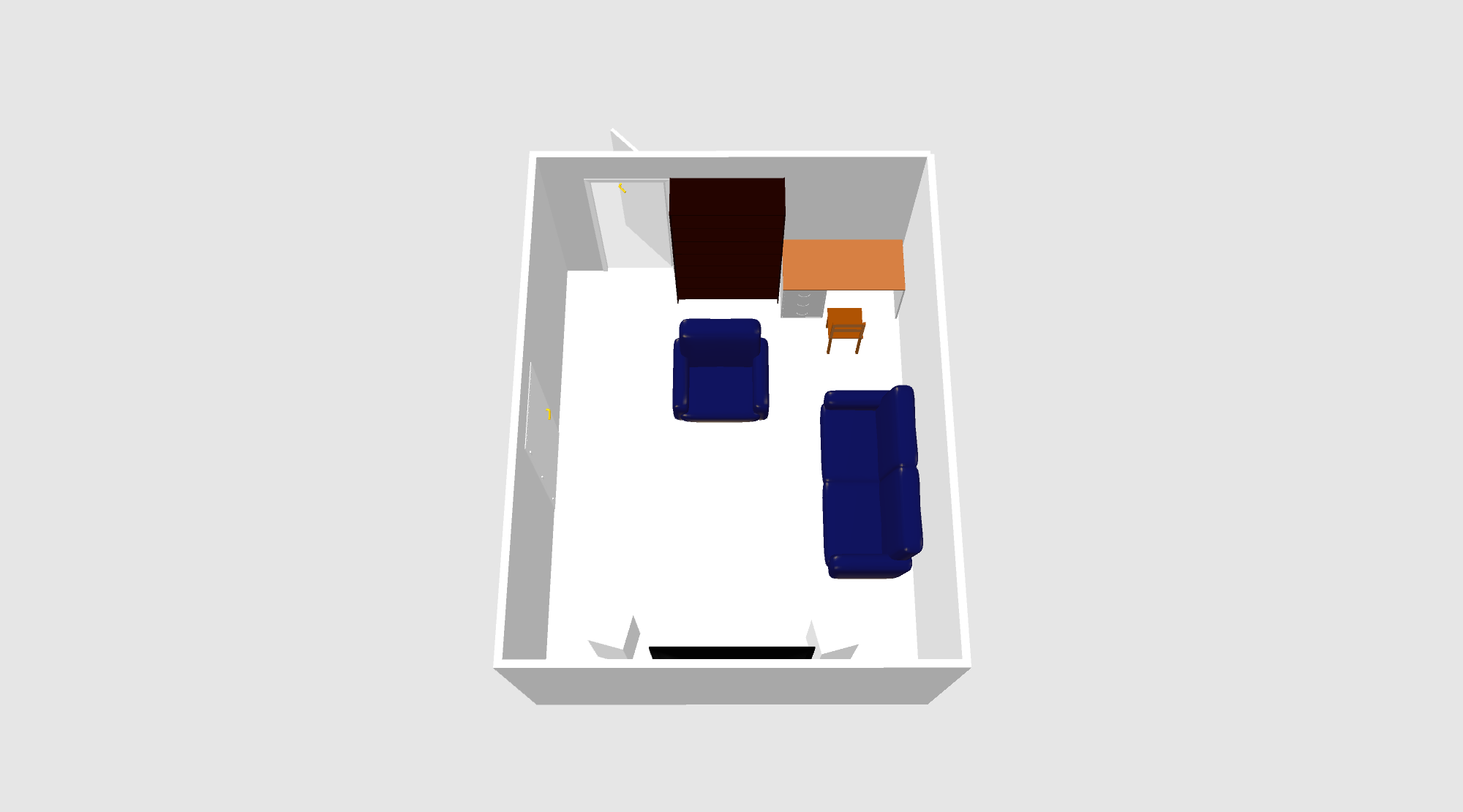

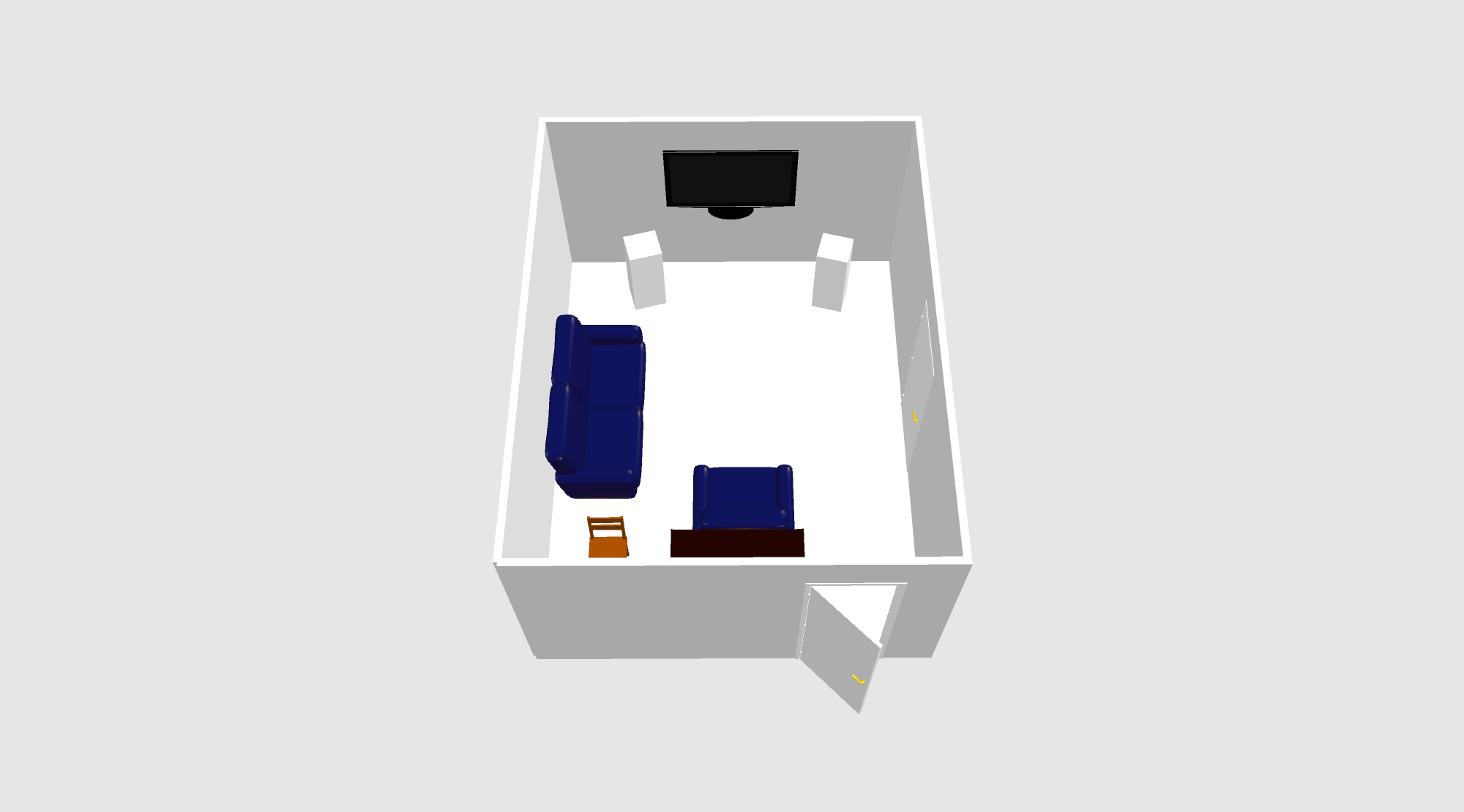

Postby Zhukovdv » 14 Feb 2022, 19:31
Вид 1.png (50.5 KiB) Viewed 6556 times
Вид 2.png (51.01 KiB) Viewed 6556 times
